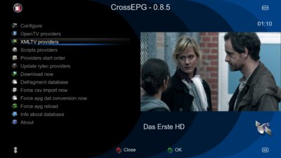

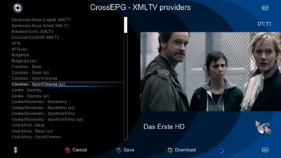

still no joy with crossepg complaining about the xz format of the source when I try to edit the rytec sources
Matrix10

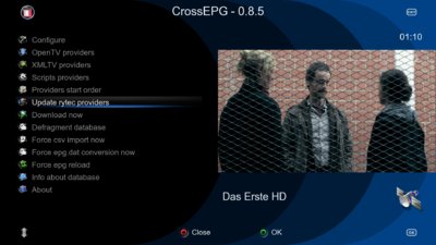

There's nothing for editing there
you install the image and do it as I wrote it.
Update Rytec sources in the Crossepg panel and use it.

clvk07
got it to work thanks. I guess when it is downloading channels you cant do anything else.
Epg import was downloading on the background but crossepg seems to block any other activity. (sorry never used crossepg before)
