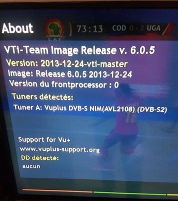

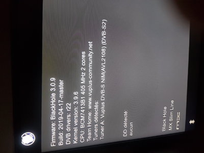

Hello

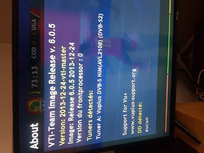

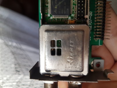

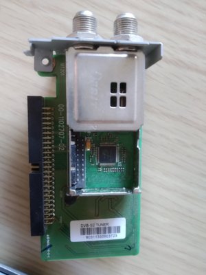

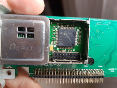

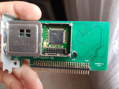

My vu+uno work only with image which used kernel 3.1.1
But when i want to use images with kernel 3.9.6 so no tuner signal
Can you help me please
You are using VTI ( an image not suppported in our board ).
If you want our help to support it!
Change your image to Open BlackHole ( with only the necessary files ... simple settings ) ... that you can download here. --> https://www.vuplus-community.net/board/threads/openbh-4-2-vu-uno.37946/
Apply Open Multiboot and install the lastest BlackHole 3.0.9 image: --> https://www.vuplus-community.net/board/threads/black-hole-3-0-9-vu-uno.39000/
To implement Open Multiboot on your STB, you can follow our guide --> https://www.vuplus-community.net/board/threads/how-to-use-open-multiboot-on-open-black-hole.23270/
If you want, take a look to this thread ( @Ev0 post ) --> https://www.vuplus-community.net/board/threads/black-hole-3-0-3-e-vu-uno.31715/#post-225680

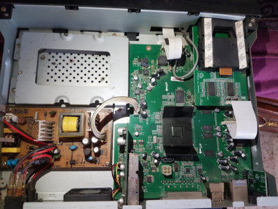

It's very strange you cannot use more recent images .... I've had some problems when Vu+ updates kernel from 2.6.x to 3.x series and I must reflash Vu+Uno CFE (my Vu+Uno is a pre-production box) with the help of a friend.
Try to use latet BH or OBH images: I'll check my Vu+Uno box ....

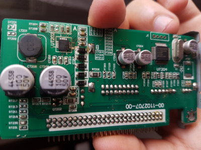

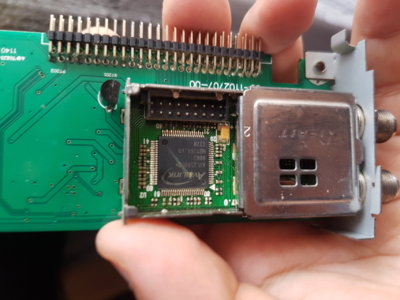

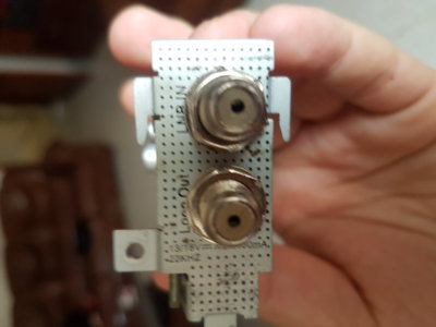

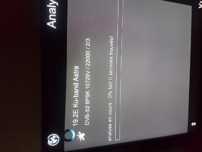

Have you test with Satfinder from tuner menu?
Go to satfinder and set to single satellite and se how the signal is behaving
If its totaly dead or if its jumping up and down
When i used satfinder the box le locked and i must To reboot
Thé same prb
So, i am waiting for some solutions

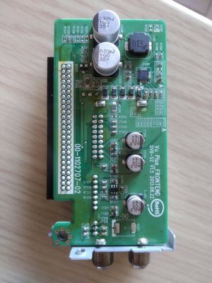

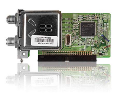

Seems the problem is your tuner.

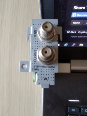

I attach on this pos 3 pics of my Vu+Uno tuner (who works regularly) and comparing with your pics seems that your tuner misses something like pin cover, type, version and production date and also on metal plate seems it's not an official Vu+ tuner ....
It's a clone?
It's a clone?
I do not know
I bought it like that at a friend's house
So , whats solution can I do it?
Its work perfectly with all image with kernel 3.1.1
High signal quality
I do not know
High signal quality
You can try to buy a new tuner from a valuable reseller or try to find one from one of your friends who have Vu+ boxes.
