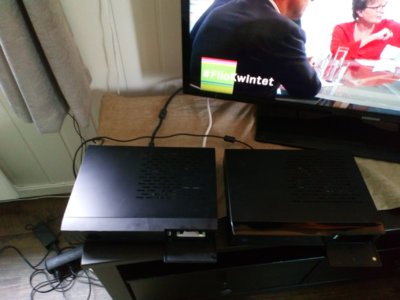

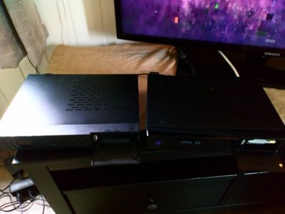

Here you see the difference between the two....look at the tv picture on the background. The solo2 i'v just for a few days, second hand....he's said it works ok ....
It should make no difference if I use the solo or the solo2, or is the solo2 more sensitive that i need to adjust the 'head' outside? Or is ther something wrong with the solo2 ?

Hi, thanks for all your reply's ! That was interesting, when i choose a Free to Air channel i've a good picture witg the solo2 ! When i use the encrypted channels ( I pay for it, for the abb.) some uses the installed card, then the screen is breaking up ( but this isn't when i use the my old solo)...so the problem is, looks like it, the card and the encrypting on the solo2? What to do now?
It right it is on the 23,3E...Using Blach hole in the solo2 ( In the solo i use Openpli)...Channels i'm vieving is the dutch canal digitaal on 23,3E ( As said: i pay for it- legal abb ther :) )
Found the solution ! Was looking at the installed Cam Module (Card)...just changed the option : High bitrate support form NO to Yes...and there is comes :)
