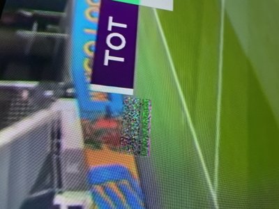

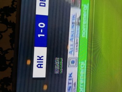

I have like you can see in the pictures a graphic error coming up in my screen. It comes and goes.
Anyone with any tips what I can do to make it disappear?

This is not a graphic error but a video error
Changing skins won't help it is a problem related to
1.HDMI cable
2.TV
3.TV video setup
4.BOX
4.Box video setup
Try another HDMI input on the TV first
Try replacing the HDMI cable
Do you have that problem if the box is on HD
and not on UHD?
Test BOX on another TV
Check the setup for VIDEO on TV and on Box
What kind of TV is that?
UHD or HD and which brand ?
When you test it, you'll know where the problem might be.
I'm almost sure it's a HW issue, either due to the graphic adapter or to other components 8included the cable, actually, as you suggest).
Looks like your using IPTV to me and your supplier is covering a logo or watermark that the broadcaster uses.
