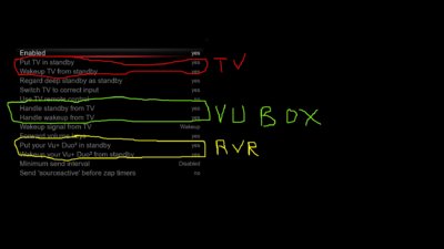

This is what you have in the GUI HDMI-CEC menu:
Put your Vu+ duo2 in standby
Wakeup your Vu+ duo2 from standby
Respectively line 11 and 12 on my duo2
This what is written in /etc/enigma2/settings
config.hdmicec.control_receiver_standby=True
config.hdmicec.control_receiver_wakeup=True
So instead of Vu+ Duo2 it should be Receiver

self.list.append(getConfigListEntry(_("Wakeup your %s %s from standby") % (getMachineBrand(), getMachineName()), config.hdmicec.control_receiver_wakeup))
self.list.append(getConfigListEntry(_("Put your %s %s in standby") % (getMachineBrand(), getMachineName()), config.hdmicec.control_receiver_standby))
Where you see %s %s .... it will return the receiver model name ( Vu+ Duo2, Vu+ Duo4K .... and so on ).

No by receiver I meant AVR AV-Receiver this code is meant for AVRs not the box!!!!! Try it, you will see when you set these options this is the AVR that goes to standy or not

It seems you do not get it, these 2 settings will put my Audio Video Receiver on/off standby not my TV, not my Duo2 receiver hence it should be written whatever you would like to call Audio Video Receiver but certainly not
getMachineBrand(), getMachineName() because this is not right.......
selecting yes at the above
DOES NOT PUT THE VU+ in standby or wake, it will operate on the the AVR (Denon, in my case)
