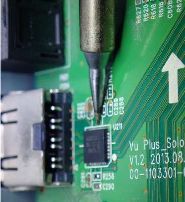

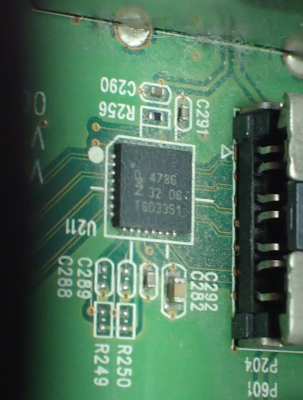

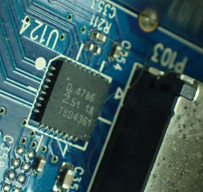

All 3 have a common chip which is IP4786CZ32. The task of this chip is to protect the CPU from ESD and Surge, any way anyone can help me test around it, please?
Thanks in advance

The IP4786CZ32 is designed to protect High-Definition Multimedia Interface (HDMI) transmitter host interfaces. It includes HDMI 5 V overcurrent / overvoltage protection, Display Data Channel (DDC) buffering and decoupling, hot plug detect, backdrive protection, Consumer Electronic Control (CEC) buffering and decoupling, and ±12 kV contact ElectroStatic Discharge (ESD) protection for all I/Os, exceeding the IEC 61000-4-2 level 4 standard.
If it is HDMI, and does not work with the direct signal, but also with the recorded one or test video with recorded video from USB / HDD then try to replace that chip.

It is not easy to remove this chip since it is surrounded by Plastic (HDMI PORT) so I need to make sure that this chip is faulty, value of the chip costs only €0.75.

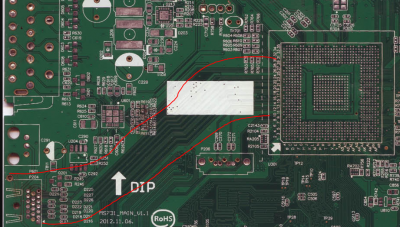

These are models from the 2013 mainboard since before this HDMI was direct tracks to the CPU as shown in my attached image, lots of people fry the CPU by just removing the HDMI while the device was ON, VU due to complaints and RMA added this chip I mentioned above as a FIX for ESD. All I need is a schematic for HDMI or values in this area if anyone can help me I would appreciate it.

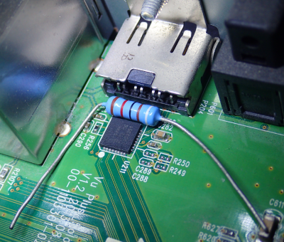

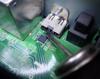

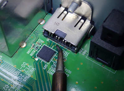

Re hot air alone it is an impossible task since these QFN packages need 350 - 380c direct heat for 7 -15 secs and space is only 5mm therefore to be removed without damage the options are 2:
1> Use an under PCB focal heater to establish the heat around 200c then apply low solder melt (170c) by covering the chip + flux and use hot air with the smallest nozzle as shown in my image, however, this will require attention not to make mass to the nearby components since it is liquid and will spread easy after heated that's how it will go under the chip and make the solder flow at low temp.
2> Safest option remove HDMI Port and protect the other plastic around it.
Both approaches will be expensive so unless I take this as a challenge I need to quote and decide from there but since they have 3 faulty there is room to work and make little profit if they get fixed.

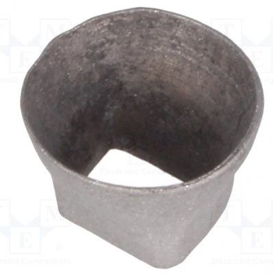

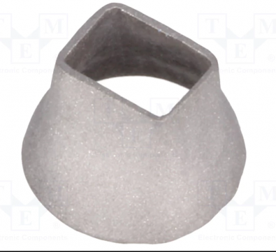

I forget to add how I would install QFN32 if there will be the need and reflow at normal temp with no damage, this is easy with the tools.
I have a kit that attaches to my heat gun with the help of a preheater in this case it is a must. This will allow perfect reflow / no thermal shock and focus heat on a small area.
For anyone interested, this tool is called a QFN protector and yes it is expensive. The model I have should be used only for installation there is 5 digit model which is out of my budget and can also extract QFN and BGA with the help of a vacuum.
