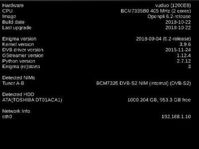

I was given a VU+ DUO details below
I have one fixed dish on astra 28.2 on port B and Port A is on a 1 meter Diseqc 1.2 motor (which i cannot get to position) yet
What image should i use for this box and the best plugin to set up diseqc motor ?
Thanks for any help to can give me cheers Jim

You are using OpenPli, judging by your attached image, which I'm not familiar with, as this forum is more for Black Hole, and Open Black Hole, but most images should work the same.
If you go into the menu, setup, Tuner Configuration, Tuner Setup, or similar, then select the tuner, connected to your motor.
You now select the simple option, then positioner, and enter your latitude, and longitude.
You can find these on the internet, or from various Apps, but I use dishpointer.com, you just enter your postcode, and move the icon to your house, and dish location.
The Longitude has either negative, or positive, co-ordinates, negative = West, Positive = East
Runcorn would be approximately Latitude 53.3, Longitude -2.7, which would be entered as 53.3 North, 2.7 West.
