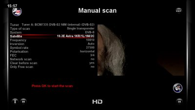

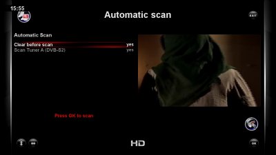

there is option to delete existing list (can't remember exactly its name) before scan. Did you select it?
If you doing auto scan loading new list is not required - your stb will pick up all available channels.
Still can't understand why you have German channels there and why you can't watch fta's
What's your tuner settings?
