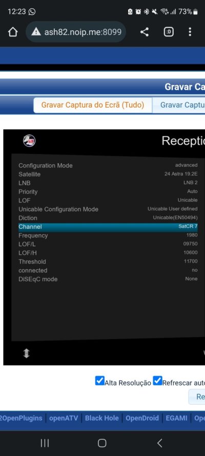

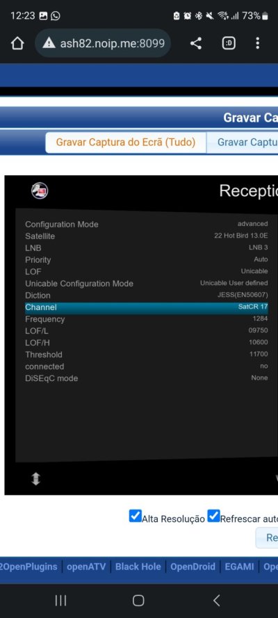

Attach my settings

I have tried connect only one lnb but under the unicable menu can't select the model I have (it does not appear)!
So I select universal unicable and the screen 10 under Jess EN50607.

Your tuner configuration doesn't look correct, especially the transponder settings, but then again I've never used a Unicable LNB.
I would still try one cable at a time, without the combiner, and do a basic settings first, single satellite, 19.2E, or 13E, then check the signal quality, in tuner settings options, or scan the satellite.
