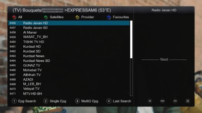

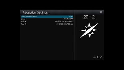

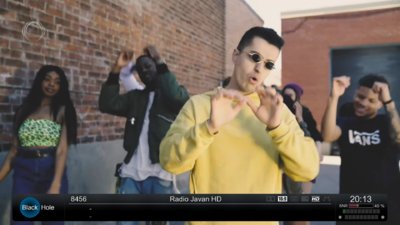

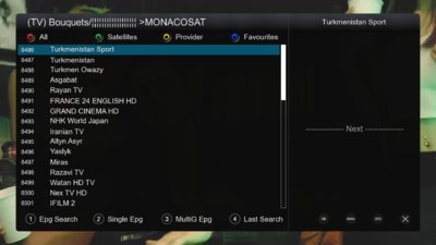

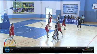

You can put it in the tuner configuration
Configuration >> simple
Mode Toneburst A / B (this is just imagined)
Port A first satellite
Port B is another satellite
And you look at both satellites if you get them well with your antenna.
Example:

As far as I know it all is not necessary.
Example:
thanks Matrix10 I will try this way to see the result.
