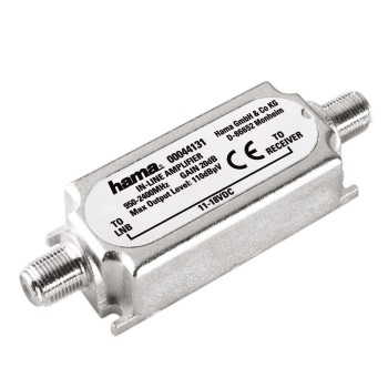

If you can't make changes to your current sat setup (as a911 said) because it's not yours, you could try inserting a signal amplifier as near as you can to the LNB, but an overall improvement in the signal quality is not always guaranteed.

wont it(signal amplifier) slightly dangerous for my receiver tuner?
