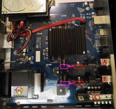

In order not to make mistakes, I clarify it better.
2 FBC Tuner.
1 DDT Tuner.
Slot A (4 + 4 Tuner DVB-S2)
Slot B (4 + 4 Tuner DVB-S2)
Slot C (2 Tuner DDT)
Look at the price of LNB unicable, 4scr with 1 Legacy 70 €, 4scr with 2 Legacy 77 €, only unicable 24scr 40 €, to have a reference.
They are about 50 € plus the extra FBC tuner.
Para no cometer errores, lo aclaro mejor.
2 Tuner FBC.
1 Tuner DDT.
Slot A (4+4 Tuner DVB-S2)
Slot B (4+4 Tuner DVB-S2)
Mira bien el precio de los LNB unicable, 4scr con 1 Legacy 70€, 4scr con 2 Legacy 77€, solo unicable 24scr 40€, por tener una referencia.
Son unos 50€ mas el tuner FBC extra.
