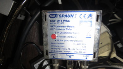

Yes, When I changed my equipment to a configuration very very similar to yours, I had to change my normal Diseqc switches and buy a Spaun Sur 211 WSG but I had also to learn that it has got a selector which decides how it works. It must be set to OPTION to have what I want.
In my case I put the cable from monoblock in its LNB1 input port and the cable from the single LNB to the LNB2 input port.
This way you let the monobloc managing its built-in DiseqC switch (which you'll set as A/B) and Port C is the single LNB.

Just to be clear, this is the switch I use and that solved my problem after I put on a dual feed LNB along with a single one. As I wrote, surely you can find many other ones, but I cannot tell you which ones are suitable as the Spaun 211 WSG and which are not because I'm not a real expert about sat accessories.
As you can see, the red selector is in the OPTION position to manage the dual feed LNB (in the LNB1 input; the other is in the LNB2 input port).

After some days of testing, I can prove that what Alexwilmac told works very well:
1 - The device I bought is SPAUN 211 WSG
2 - And the tuner settings on the device must be:
Monoblock is 13/19°E & Single is 28,2
"Simple" configuration A/B/C/D
A=Monoblock 13°E
B=Monoblock 19°E
C=Single LNB 28,2°E
D=not present
Thank you so much! :)
