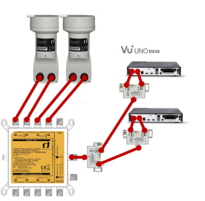

So I am having a hard time configuring this, first the physical setup is this correct?
LNB1: Intelsat/Thor (0,8W - 0,9W)
LNB2: Sirius (4,8E - 5,0E)
I was surprised that I needed splitter for each VU UNO thought I only needed one cable (UNI CABLE LOL)

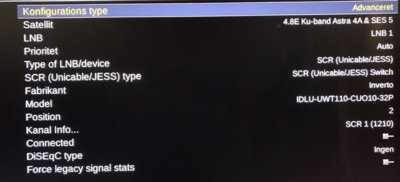

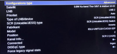

I have done some trial and error test and it seems that model: should be 2? (Custom programming?)
LNB1: Astra
LNB2: Thor (Some signal problems here)
Some tuners work some doesn't, and TV is working on channel D....

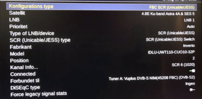

I found that the LNB's have Vertical & Horizontal output and these was mixed between the Switch and the LNB's so now I have this.....
I also found that model: 2 is needed to get any signal for the two LNB's so far so good

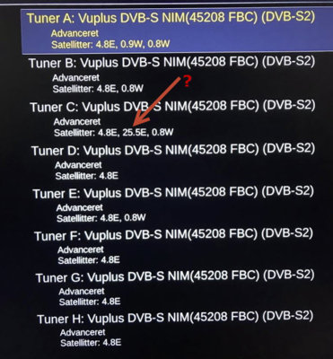

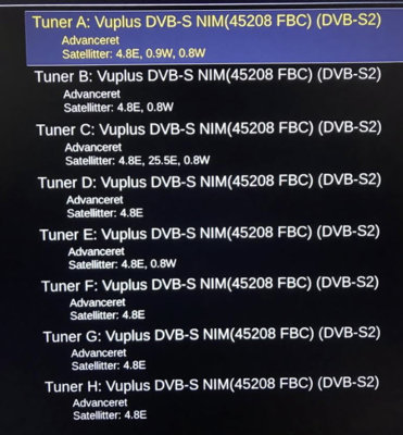

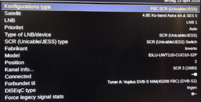

I really dont get why I have 25,5E on Tuner C ?

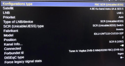

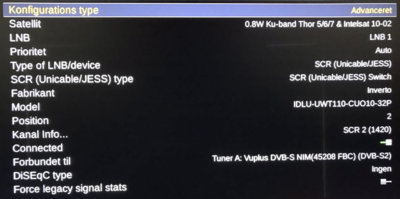

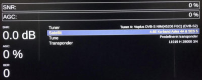

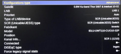

Tuner A:

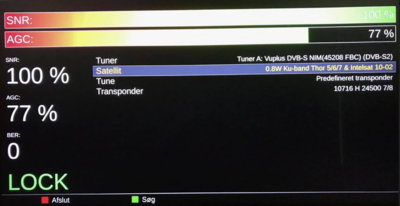

Tuner A signal: LNB1 Thor
Tuner A signal LNB1 Astra

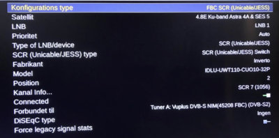

Tuner B points to Tuner A

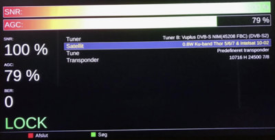

Tuner B now get a signal from Astra !!!! (Not a great one but from the other LNB - even if both configuration is pointing to LNB1 - Unicable = 1 LNB?
Tuner B Thor same as A 100% signal

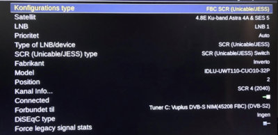

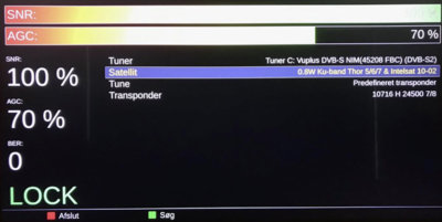

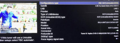

Tuner C points to tuner B

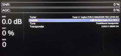

Tuner C no signal on Astra (Only Tuner B have signal on the other LNB every other is now 0 signal
Tuner C - Thor 100%
So this is done by trial and error, and searching channels afterwards is also very time consuming
since it seeks for both Thor and Astra on all 8 Tuners! (This must be wrong?)
Hope someone can share some insight into the mysteries of Unicable....

It is normal to have data of tp/similar frequencies in different satellites, so it indicates signal, then I look at the photos well, years ago a receiver adjusted to Hispasat, you put it in Astra 19E and channel plus france directly without touching anything.

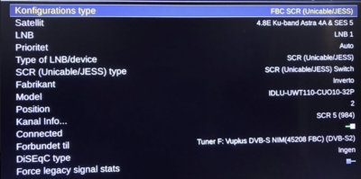

The tuner B, F, G, H have to be configured with the correct SCR and also with loop to tuner A to have a signal.

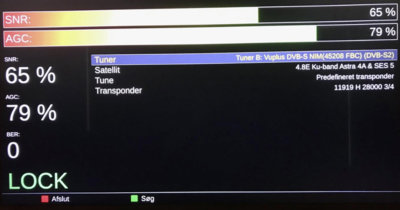

Intelsat 10-02 - Thor 5/6/7 a 1ºWest
11919 V 28000 3/4 Bad...V
11919 H 28000 7/8 OK....H
Astra 4A/SES-5 a 4.8ºEast, beam Astra-4A BSS Nordic
11919 H 28000 3/4

The 25.5E satellite by mistake you put it on.
Ahora miro lo que comentas, voy despacio.
El satelite 25.5E por error lo pusiste tu.

I just changed each tuner to point at Tuner A (All tuners B,C,D.E.F.G,H all points to tuner A)
I tested this and I can now record from all tuners at the same time (tried it on 1 box) and it works!!
BUT I only have 0,8 Thor satellite for all my channels the Astra signal is not shared and I cant find any channels searching on any tuner
The signal finder does show that it have 65% on Astra channel so the LNB 2 is not really working in the switch?
Just my observation
What is the splitter function for each receiver if you use the tuners loops ???
You can only loop physical tuners in particular A---B (virtual A-H) and I----J (virtual I-P)

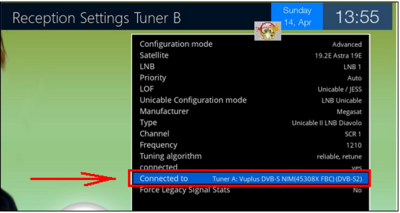

Following the link I get this picture:
https://www.world-of-satellite.com/attachment.php?attachmentid=57382&d=1536108780
attachment.php
That is why I added the splitters to the boxes.... Should I try to remove them and see if it works...
I agree Loop from tuner A to all the rest should make the splitter before the box unnecessary!
Okay - Removed the splitter and there is no difference! :dance:
But Tuner B is still the only tuner showing signals from both satellites? Astra 4,8 & Thor 0,8 satellite
All other tuners only show signal from Thor 0,8?
The tuner C still show this 25,5E and I have excatly the same configuration on this tiner as on the other ones? (But I dont think its a problem just an irritation)
Searching channels it looks for channels on tuner A and then Tuner C
Television is working but only from Thor 0,8
