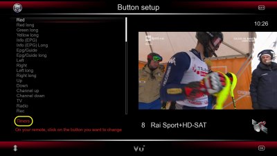

For instance, when you enter the "Button setup" section, if you'd like to assign the TIMERS list recall to the RED button (RED meant as one of the 4 coloured buttons, of course, not the Instant record one), just do that:
-immediately after entering the submenu Button setup you'll see the list of key that's possible to program
As you can see from my grabbing 1
as soon as you enter is already "selected" the first item, RED and, if there is a function associated to it (as in my case) as I wrote above you can read which one in the penultimate row of this screen. In my case you read "Timers", otherwise it'll be blank.

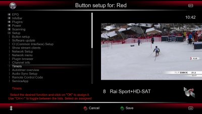

If, as I suppose in your case, there is nothing, you must just press RED (my mistake, the first times was exactly this: I pressed OK because I supposed I needed to choose the button among this list! or I pressed the DOWN arrow meaning to go downwards in the list. But if you press "Down" it'll think you want to assign a function to this button) and then you'll see this (in Grabbing2)

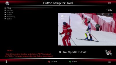

Now, yes, now you can browse all those sections by the UP/DOWN arrows to program some key_s. So, if in the example, you want to assign the Timers command to the button you chose (RED) it's among the Setup section (Grabbing3):
Go down and select it by OK.
If, as I suppose in your case, there is nothing, you must just press RED (my mistake, the first times was exactly this: I pressed OK because I supposed I needed to choose the button among this list! or I pressed the DOWN arrow meaning to go downwards in the list. But if you press "Down" it'll think you wat to assign a function to this button) and then you'll see this (in Grabbing2)
