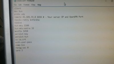

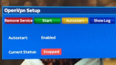

Sorry to bring up and old post and ask the same question. I am using Openvix 5 on Duo2. I have OpenVpn set on my box .I have a VPN provider Digibit, they have sent me the following ca.crt, openvpn config files and I have my user and pass word. I have tried using Telnet via the Vu+ Control Centre, but it say options error: In CMD-LINE. Can I use FileZilla. I have enclosed 2 Pics 1 is the config file set up. Any advice.
Where is the certificate info ?
