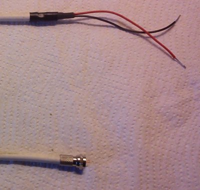

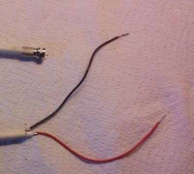

Make your F-connector power supply adaptor

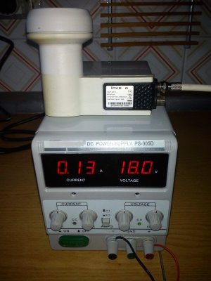

Connect your LNB, or all your Sat installation to an external power supply to check short circuits/power consumption.

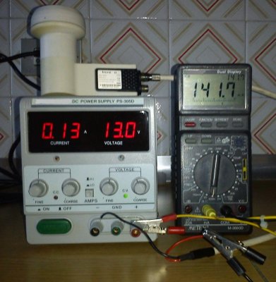

I used adjustable linear power supply with V/A display (costs about 50,- Eur) to not to use an external multimeter.
But to be sure, I did current measurings with external Multimeter too.
I used for tests Inverto Twin LNB.

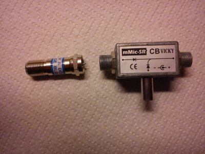

If you want to check your installation "online", use some DC Injector and DC blocker.
Please, don't overvoltage your Sat installation! I consider Max. of 18,5V.
Warning: Current consumption of your installation over 400mA can damage your receiver! So if you measure values over limit, check your installation!
