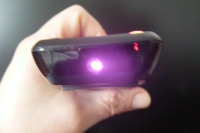

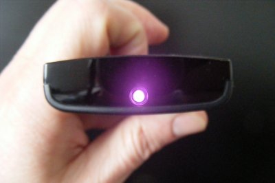

1. Use your digital camera, smartphone, webcam, ...
2. Point your RCU to your camera lens, look at LCD device display.
3. If your RCU IR transmitter is working well, you should see white/violet light of IR LED on your display after pressing RCU buttons.
PrismCube Ruby RCU
Vu+ Solo2 RCU
4. If you can't see nothing or very low intensity of light, change batteries at first.
