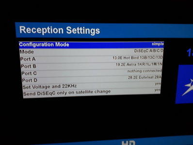

Tuner A is connected to a Disec switch 4 port, A = 13 E , B= 19 E , D= 28E cant make mind up for 4th bird
And tuner B is cable

Your Tuner configuration should be simple, Diseqc A,B,C,D, and configure the ports, it's pointless setting all four to 28.2E as the LNB will only be connected to one of them.
If 13E, and 19.2E, are working check the connections to 28.2E, then try running a co-ax cable, directly from the 28.2E LNB to your receiver, bypassing the Diseqc switch, and see if it works.

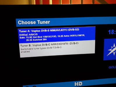

20150526_131933.jpg No channels on any bird work, all are greyed out, and error when selected

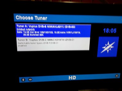

Its as if the tuner card is not working

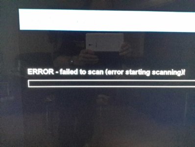

Above error message when trying to scan channels and tuner config20150526_131949.jpg
