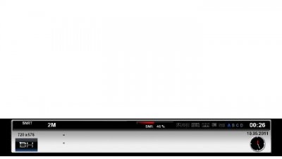

hi every one ,
once permanent timeshift pluging installed , the infobar won't show up in channel change and when Ok button pressed , it just disappear . can this problem be solved?
yes i rebooted the box after installation.
the infobar show up in channel change .( not like as i mentionned in 1 st post)
the problem is when i press OK button the infobar does'nt show up

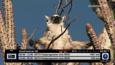

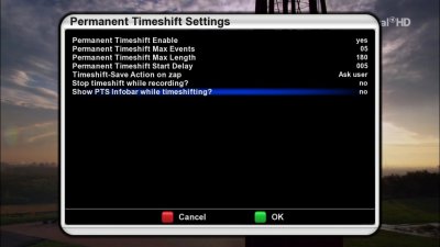

Image OSD infobar
or Timeshift infobar ??
I have image OSD infobar with and without Timeshift plugin installed.
I have no problem with the OSD infobar if I install Timeshift plugin

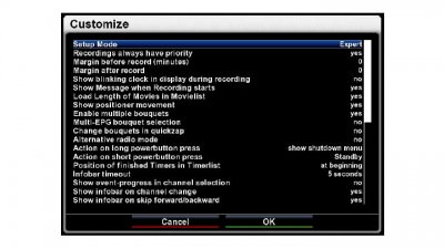

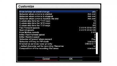

Is your configuration for Infobar timeout in Customize panel OK ??
May be i have not explained well :
when no osd on screen , and i press OK on the RC , nothing shows up ( normally the osd infobar must show up)
