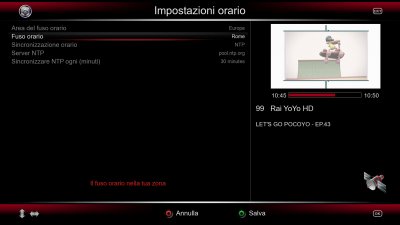

3) no plugins are needed for that in OBH: MENU/Setup/Time and there you choose the NTP option

What is you location, mate?
Have you setted your time zone area location, at:
> Menu > Setup > Time?
Note: Can you post a screenshot of that configuration?

France isn't location London, is plus 1 hour (+1).
If you put your vu+ synchronize a free channel in package the hours is ok. With the net in ntp does't work. I thing.
The ntp doesn't work?!? I've been using it for 3 or 4 years and it has never failed!
It is all the way around: it is one of the most useful OBH function! :-)
I noticed a problem, following the time change, as the clocks went forward, + 1 hour, that my receiver didn't automatically change, but stayed 1 hour behind.
Evo knows about the problem, and is working on it, but you can fix it by using the VU+ Control Centre, Telnet option, and sending this command, to your VU+ receiver:
opkg install --force-reinstall tzdata tzdata-core tzdata-europe
I just tried it and it does work. If this was your time problem please try it.
