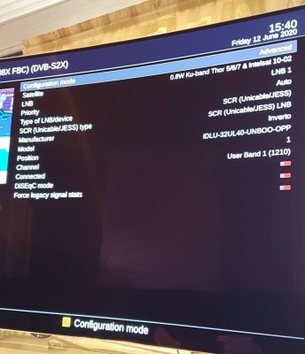

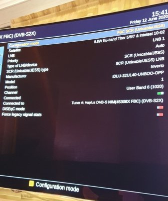

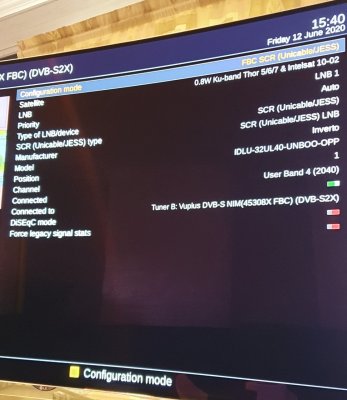

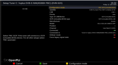

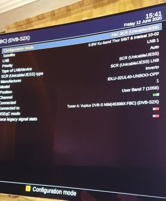

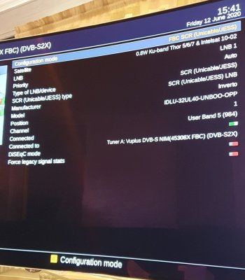

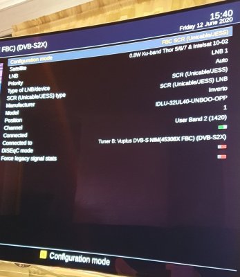

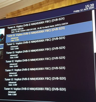

I have problems with freezing pictures on some TV-channels. I have tried a lot og things to sort it out, but I'm not able to find the error. From these pictures, can you tell me if the set-up is as it should be?

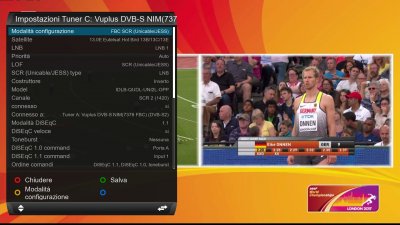

First of all, please, next time use a very comfortable feature of our images to send pictures: not the phone but type in a browser the IP of your box followed by grab (and then save the picture as you do when you browse the Internet. For example, if your box's IP is
192.1.2.3, just type
192.1.2.3/grab
And, also, attach them all together: this will make possible to us to "browse" them instead of viewing them one by one.

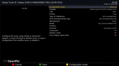

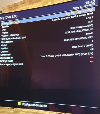

Then, in your configuration, you connected some virtual (FBC) tuners to Tuner B (that's correct) but others to Tuner A.
It was difficult to browse your pictures this way... One is also rotated, thanks to these terrible smartphones ;)
Attached an example of grab, that provides a perfect result ;)

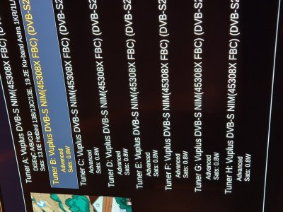

Also: why did you configure Tuner A as DiSeqC A/B/C/D if you got only two satellites? You should use DiSeqC A/B, instead.

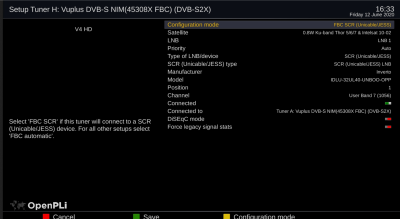

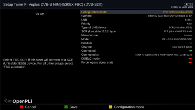

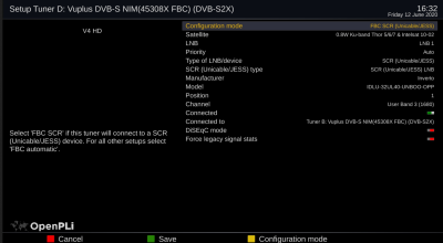

How can I do so it's possible to step through them?

Yes, in tuner F, G and H, simply switch the field "Connected to" from Tuner A to Tuner B.
Also avoid, if possible, to connect this LNB through a Diseqc switch, because it's possible but it's tricky...
So, as you've got two physical tuners and then two inputs, connect (as I believe you already did) the DiSeqC switch to the physical Tuner A and the SCR to the Tuner B (that means also to the virtual FBC tuners C, D, E...).
You were almost arrived: only you did not set Tuner A also for the last FBC tuners. Change this and it's perfect.
Thank you, I'll try this. The LNB's from 19.2, 13 and 4.8 E is on a switch going to input 1 on the receiver. The 1W LNB goes direct into input 2.
