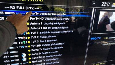

@absmo - Hello, found the solution yesterday and applied and WORKS bro... i have picons and epg and shit :dance:
Search e-channelizer, install it, subscribe for a 14 days Trial version -you need only name and email address (all premium features became available) and go play with the software :)
!!! BE AWARE !!! Make back-ups from your userbouquets, lamedb etc to avoid issues with your Favorites bouquets.
I'm away to say that i'm an expert but if i will have time i will make a small guide (there is a few guides over the net)
Cheers & have fun
