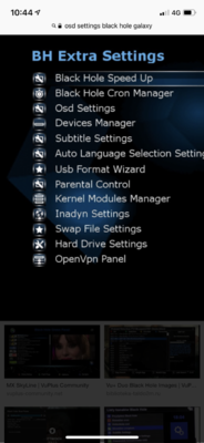

see attached maybe i need to go osd settings to change the default player?
the boucets for the iptv is not the problem the problem iam almost sure of is the default player for these iptv boucets is wrong and i have seen on xtreamtv that when you have wrong settings on player they dont work.
why cant i install serviceapp on black hole galaxy 3.0.8? after install from GUI it just still say activate in speed up black hole menu?

I'm sorry but I do not understand all your problems.
1.In Black Hole Speed up you can enable or disable Serviceapp
If enabled you can use Serviceapp
In Menu>>Setup>>System>>serviceApp>>You can setup ServiceApp
You can setup and use Enigma2 play back or serviceapp play back
(for setup use remote buttons left/right up/down)
and you can use exteplayer3
so you can use 5002
Buttons for VOD you can enable or disable in System>>Customise panel.
For the rest, maybe someone else can help
who uses a similar configuration of yours
