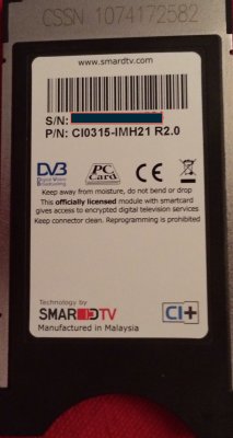

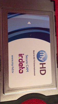

Hello,
I have an irdeto Secure CAM (for my-HD) which was working fine with my old vuduo but my new vuduo2 is not even detecting it.
When I go to Settings/Common interface, I see "no module found".
I tried on both slot 1 and slot 2, same result.
I'm using BlackHole 2.0.9.1.
Previous versions of BH 2.0x are giving the same result.
I also tried flashing the official image with no luck, still not detected.
Any ideas please?
Thanks

Hello,
Any ideas please?
Thanks
