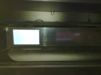

please help me . from yesterday LCD in duo2 only shows white screen and no clock , picture , programs and .... . I only can increase and decrease the brightness from 0 to 10 .
I clean flashed it but nothing changed .
the picture attached . you can see it .
I clean the socket with alcohol and eraser . but nothing changed .
I use BH 3.02F ( 2016/9/5 ) .
I tested . I cannot manage lcd4linux from webif in my computer .
it said :
Error 404: Page not found
The requested URL was not found on this server.
the url is correct and i can manage other part of device from webif or dcc .
today i focus on it and i see that the line of clock and program name is a little black from other part of screen .
the lcd is white and noting shows . only i can increase and decrease the brightness of lcd .
please help me .
So if you look at lcd4linux from box on tv screen everything working ok ? board should be ok Usually it would point to loose or bad connection between the lcd and board or as pointed out maybe defective lcd. Sorry but i can't offer any advice on testing the lcd screen itself other than swapping one. If you are having problems viewing lcd4linux on tv screen it maybe hardware related.

It seems the high settings may have ended the life of the lcd. One option is to return to where you purchased to have it fixed if it is still under warranty. If not under warranty then you could try vu+ for lcd this maybe more difficult. Other than that go into lcd4linux settings and in enabled select no then restart gui this will turn off lcd screen. You can now check if the box works fine now without the small lcd just to make sure there are no other hardware problems. hth
