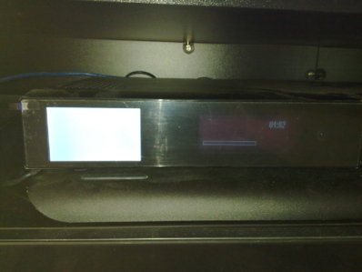

please help me . from yesterday LCD in duo2 only shows white screen and no clock , picture , programs and .... . I only can increase and decrease the brightness from 0 to 10 .
I clean flashed it but nothing changed .
the picture attached . you can see it .
I clean the socket whit alcohol and eraser . but nothing changed .
please help me .

4 - today i focus on it and i see that the place of clock and program name is a little black from other part of screen .
