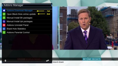

Today I tried before to solve reinstalling from scratch, hoping I could download the plugin from the 1st section in the picture attached. But, again, it was impossible to connect to this server.
My suspect is that the plugin you can download from the 2nd section is not the right one for Duo2. Surely, it does NOT have the Duo2 specific display to choose in the Global/Other section!
But I could not verify my hypothesis.
