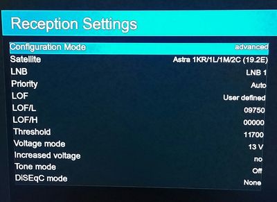

What really surprised me is that with the following configuration for Tuner A:
Bx4NHQhyRI2_Do8isAurdFQW2Y1TCetT-jSGctz5SP8?size_mode=5
The receiver still tries to use it for HORIZONTAL-LOW, obviously unsuccessfully.
I have not found detailed documentation, but I have supposed the following:
  • Threshold=11700 --> Tuner A is not valid to HIGH band (it seems working this way). HIGH band starts at 11.7 GHz. HIGH channels always use Tuner B (that has the four bands of 19.2 E).
  • Tone mode --> Off (no need no send 22 kHz tone, besides LOW band requires no tone).
  • Voltage mode (Polarization indication) --> Can have 3 values:
    • Polarization (I suppose this puts 13/18 V automatically depending on the channel belonging to a VERTICAL or HORIZONTAL band)
    • 13 V --> Vertical?--> This seems not working, or I do not know what is this for. I going to measure if the voltage is present. For me this would be the indication this tuner is only valid for vertical polarization and it should not put any voltage.
    • 18 V --> Horizontal?--> same doubts than for 13 V but for horizontal polarization.
Maybe I have misunderstood those parameters. Any other suggestion?
Then if I search the channels with Tuner A, and put Tuner B as preferred... only for 19.2 E VERTICAL-LOW will Tuner A used in first place? All other channels in 19.2 E (including HORIZONTAL-LOW) will use Tuner B? (I will try this).
Thank you for your answer and suggestions!:thanks:
I cannot see your image, detailing your Tuner A configuration.
Did you set Tuner B to be your preferred tuner?
You could try the Advanced options, in Tuner A setup, and try changing the LNB settings, LOF, LOF Low LOF High, etc, so that only the Vertical low frequencies can be selected.
