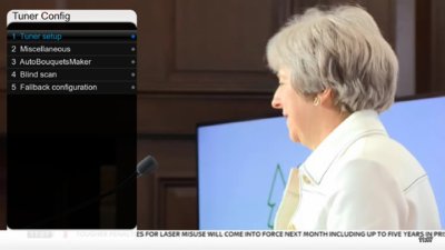

For some reason I seem to have some items missing from my Tuner Config screen which mean I am unable to do an automatic scan.
I am running OBH 4.1.030 on Vu+Solo2
I see only,
Tuner setup
Miscellaneous
AutoBouquetsMaker
Blind scan
Fallback configuration
How do I get it back please?
Thanks
Azam

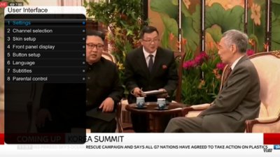

Just checked my receiver, VU+ Duo2, Open Black Hole 4.1.030, and I have all the options.
However I did revert back, from the last image update, I tried, due to changes to KODI, which changed some of the functions, of the keys.
Have you checked in User Interface options, to see if you can enable more functions?
The 'User Interface' panel appears to be complete. However, nothing there which can enable tuner functionality.
I've gone deeper into all the Settings panels and they all seem to be as they should. It's just the Tuner Config one which isn't.

Just to update you on this.
I swapped my satellite cable from Tuner A to Tuner B and the full Tuner Config menu items reappeared. So I guess Tuner A has hardware failure.
I only have one satellite feed so will just use Tuner B only for now.
Thanks
