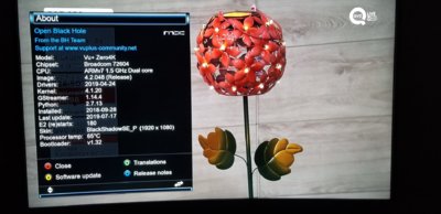

Can you please, take a screenshot like:
1) Restart enigma2. And after restart enigma2:
2) Press <MENU>; choose INFORMATION and press OK; choose ABOUT and press OK.
Take a screenshot and upload it here!
