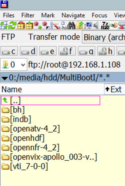

I have BH 2.0.8 in flash, not 2.1.1. Another opportunity: With MultiBoot plugin of OpenSpa in flash I was able to load from USB the following images: BH 2.1, OpenHDF, Open VIX Apollo 003, VTI 7.0, and INDB

Don't jump to conclusion. With BH 2.08 in flash there are VTI 6.0 and others in Meoboot that are compatible with BH drivers. With OpenSpa 3.1 in flash there are VTI 7 and others in MultiBoot that are compatible with OpenSpa 3.1 drivers.
