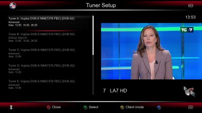

Reading today the "Release notes" of 4.3.019 and its bug fix about SCR LNBs and Universal ones, I had hoped the issue about recording from one of them and watching from the other type of LNB by a normal DiSEqC switch would have finally been solved.
But it's not so.
I finally had the time to try also by BH in flash and it happens the same thing by 3.0.9. So it's a general problem or due to my Switch... but it's a good Spaun.
I wanted to update this post because there have been other users with the same "mixed" system and I found a way to trick the system.
In brief, summarizing the situation, the scenario is made of:
1) ONE Unicable/SCR LNB
2) some Universal LNBs
3) A normal DiSeqC switch.
Then there is a variant as in my case, because maybe you want to take advantage of having a double output Universal LNBs with two tuners, in order to watch/record/PiP/Stream from different transponders also for those satellites received by a Universal LNB.
As I wrote before, here and in another thread, answering a user, the real problem, with a mixed configuration and a normal DiSeqC switch, is not the zapping, that is managing all the different LNBs of different types.
The problems is, in case, the simultaneous watching/recording etc...
I solved not using the default AUTO option in the priority field of tuner configuration. So here is my configuration.
Remember that tuners' names may differ from a VU+ to another. In my case, I have two SAT tuners, which are A and B.
The FBC virtual ones are C, D, E (and that's all in my case, as my SCR is only a 4-channel one). For those who have a 8, 16 or 32, a slight adjustment will be needed, but I suppose that following the logic I used, may help with these systems.
That said, my system has got, in particular:
1) ONE Unicable/SCR LNB for 13E
2) 3 Universal LNBs, 13E, 19,2E and 28,2E
Tuner B is the one that uses only Unoversal LNBs, so it is simply configured as
Configuration mode: simple
Mode: DiSeqC A/B/C/D (or less, in case you have less LNBs. If you have more than 4, you'll need an ADVANCED configuration, of course)
TUNER A
(is the one where are connected either the Unicable-SCR and 2 of the 3 Universal LNBs)
Satellite: (13E, in my case)
Configuration mode: ADVANCED
LNB: LNB 1
Priority: 1
Type of LNB: Unicable/SCR
(then you must, of course, choose your manufacturer and model, or discover the SCR channels of your LNB.)
Connected to: NONE
DiSeqC mode: 1.0
DiSeqC 1.0 command: Port: A (or AA, for non-open images), that's input 1 in the switch
Force legacy signal: YES (but this is a parameter I think it's not influent)
TUNER A
(for the 2nd LNB)
Satellite: 19,2E (in my case)
LNB: LNB 2
Priority: 33
Type of LNB: Universal
DiSeqC mode: 1.0
DiSeqC 1.0 command: Port: B (or AB, for non-open images), that's input 2 in the switch
the remaining options like in previous case.
TUNER A
(for the 3rd LNB)
Satellite: 28,2E (in my case)
LNB: LNB 3
Priority: 34
DiSeqC mode: 1.0
DiSeqC 1.0 command: Port: C (or BA, for non-open images), that's input 3 in the switch
TUNER C (FBC)
(now, the FBC virtual tuners to be connected to Tuner A by the SCR configuration)
LNB: LNB1
Priority: 2
Type of LNB: Unicable/SCR and the related options like in Tuner A - LNB 1
Connected to: Tuner A
DiSeqC mode: 1.0
TUNER D (FBC)
Everything like for tuner C, except
Priority: 3
and the same idea for the remaining FBC tuners, with priority set to 4, 5, 6.... as the Universal LNB are set from 33 onwards (because the 1-32 values are for the SCR LNBs)
I'm also sure you can assign to ALL SCRs LNBs the same priority. But, just to be sure...
