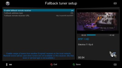

I don't understand your suggestion, sorry! :sad: What is the option I should set? And in which box, the server or the client? My box at home (server) is like in the picture attached. The other one (client), I presume (today I'm not there) is configured the same way.

Just finished testing ... a box server in BH and the client box in OBH.
In OBH in the box server until we can see the IP of the client box ... I do not know if it is possible in BH, I did not find it. On the side of the box server there is nothing to configure ... simply.

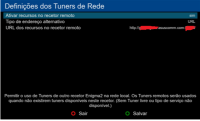

It does not matter if the list that is in the client box is not the same as the one on the box server ... obviously that should be the one you normally use and if you have more than one box, it is normal that the list is the same in all boxes ... here is, although having 2 Zero 4K only connected to Hispa, the network tuner does the rest. The request has to be made with the possibility of the box server: if the box server only has Astra, the client only you can request channels on this satellite. Of course, if the box server has more than one satellite, you can make them available. Here I do not have a rotating antenna, so for this situation, there are certain other assumptions.
mfUOSg0.png​
You may not be able to get the port issue ... First of all Falback Tuner works with port 8001. But you will not open this port ... if your hostname or IP is known and you have this port open anybody see from you ... then you will define a door pointing to it. I have here TCP / UDP defined for this.
