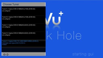

The Black hole 2.1.7 with single hybrid-dvb-c/t2 tuner in slot a ,single DVB-S in slot b and dual DVB-S in slot c i thought reading around that i should be able to use the Vu+ Turbo with this too but when i connect it with loopthrough from slot a and start and restart box i have no picture on DTT channels at all says i have signal and there is no extra tuner detected, Still no extra tuner when feed is connected straight to VU+Turbo, i do have the latest drivers from last sept would i need to install special drivers for the VU+Turbo , i thought Black Hole was ready for this ?
The drivers should already be in BH 2.1.7, have you double checked there isn't a 2nd page in the tuner configuration menu with the turbo on it (at the bottom of the list).

The Turbo should be detected even with no feed going to it.

That did the job , fresh image en the Turbo was there , thanks for your help and time Evo.
still don't really understand why but maybe it just needed fresh configuration of the tuners.
working perfect now
