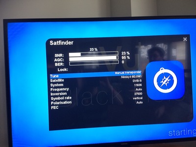

This is the configuration, AGC is what I would like SNR to be, why is AGC so far? Thanks
1) Because there´s nothing to receive in this frequency.
2) Frequencies from this sat position: [ 12224; 12676 ]

There is no such frequency, that I can see, listed on Nimiq 4, 82W, at least according to lyngsat.
Did you check my link?
The first listed frequency, of Bell TV, is 12224 R 21500 DVB-S.
Beaten to it by Nunigaia, while double checking the frequencies.
