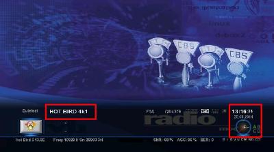

I even made recordings of channels 4K (UHD) in the VU + DUO2, these to see, need a PC ponten + i5 and a good video card.
For if it is for 10ºEste.
Emission in 4K (UHD) in 4:2:2 has to be a very very powerful PC, with i5 nones.
First I would have to run streaming to a channel 4K (UHD), memory of a companion last year, or with i7, I do not comment the video card used.

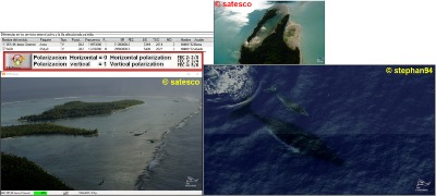

Estas fotos son del canal 8K en Astra 28.2ºE el 10-7-2019
These photos are from the 8K channel in Astra 28.2ºE on 10-7-2019
Satesco y stephan94.
Estas fotos tienen mas años, grabadas con Dreambox800S-HD y VU+DUO2 entonces.
These photos are older, recorded with Dreambox800S-HD and VU+DUO2 then.
