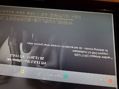

teto.71
I do not know guys
unfortunately I only managed to update it and the screen of the changelog seems clear enough. however I repeat I have not yet done the practical test since I have to reset it. remove the octagon Sf-4008 and re-fit the ultimo 4k

batiradi77
I have done it in multiboot after having installed the latest updates and nothing has changed.
No multistream channels in sight, not even signal from their frequencies for Solo 4K. :)
I have too VU+ solo 4K and no working multistream :( Big garbage reciever
