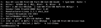

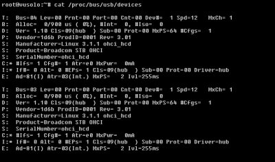

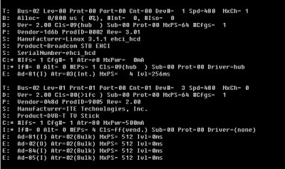

I need the output of this command:
cat /proc/bus/usb/devices
I don't know your device :(
Ok, check out the following 3 screenshots.
I couldn't figure out how to copy paste the text so I had to take screenshots of DCC telnet window to show you the content.

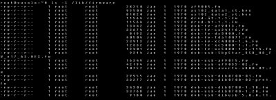

I need one more info:
the output of "dmesg" command when your box is restarted with the USB DVB-T stick connected. You can store the output into a file with this command:
dmesg > /tmp/dmesg.txt
Next, upload dmesg.txt file here.
Here is what I did:
I unziped the content of your file and tranferred it to lib/firmware.
I restarted my Solo, and went to tuner configuration where there was only again the internal tuner and no other tuner.
Excuse my ignorance and I hope I have installed it correctly but it didn't work ... :(
Here is what I did:

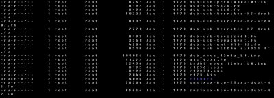

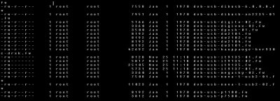

Post a new dmesg output using the same instrctions posted above in this thread.
Here it is again in 4 screenshots:
