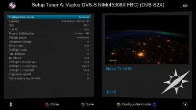

I just bought a used Wavefront toroidal dish with 8 lnb's and a EMP Centauri diseqc 1.1 switch for 8 lnb. Setting up the dish is easy enough but need help with tuner configuration. Can somebody give me a walkthrough on how to configure 8 lnb's?

Try configure it in advanced mode!
LNB1 - Input1
LNB2 - Input2
LNB8 - Input8
...and, obviously, choose each of your tuners for each LNB.
