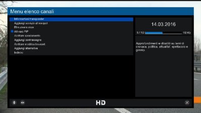

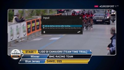

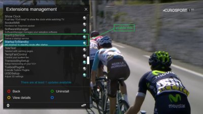

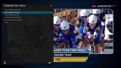

You can set a default channel that, when you power off or wake it from standby for allways going to the same service channel.
1) - Choose a channel to your desire
2) - When showing the Channel List go into the channel you want to choose ... press MENU and assign the service as :
1.1 - Set as start up service
1.2 - Set as start service from standby.
If I do not remember correctly, all channels you get EPG (2 lines minimum) from will sett the time of the box.
So set the box to your preferred channel with EPG, then go to Shutdown, and restart GUI.
With next power off, box will start with this channel, and set time correctly.
