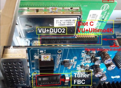

Last question: I have my good old Duo2 that's working so well after 5 years, and I would like to upgrade terrestrial tuner with one DVB-T2 card. Is this card the same used in newer 4K boxes, or is it a different, older card? Thanks.
The VU+DUO4K uses cards with a FBC connector, they are not compatible with those of the VU+DUO2.
VU+DUO2 uses the cards with the old normal connectors that are valid for the VU+Ultimo4K, it has 2 slot FBC and the 3 Slot C is compatible.
VU + DUO2 with DVB-T2 tuner (TDT2)
For information of the DVB-T2 channels in Germany, they will not be compatible with the new HD channels in DTT2 due to codec issues, in Spain there is a test broadcasting in 4K (UHD).
El VU+DUO4K usa tarjetas con conector FBC, no son compatibles con las del VU+DUO2.
VU+DUO2 usa las tarjetas con los viejos conectores normales que valen para el VU+Ultimo4K, tiene 2 slot FBC y el 3 Slot C es compatible.
VU+DUO2 con tuner DVB-T2 (TDT2)
Por informacion de los canales DVB-T2 en Alemania, no seran compatiblebles con los nuevos canales HD en TDT2 por temas de codec, en España hay un test emitiendo en 4K (UHD).
