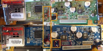

From where can I order VU+ DUAL TWIN 2xDVB-S2 Satellite Tuner (Blue PCB) for VU+ Solo SE V2?
Please refer to the attached image.
:help::help::help::help::help::help:
If they send you by mistake the green plate.
The green and blue plates in theory have to be equal, the difference is the position of the capacitor CF53, for the VU + Solo SE V2 as in the blue photo.
I comment on it if you have trouble finding it.
I have the 2 plates and are worth for the VU + DUO2, Solo4K, Ultimo4K (Verified 100%).
Blue VU+Solo SE V2 (I do not have).
Si te mandan por error la placa verde.
Las placas verdes y azules en teoria tienen que valer igual, la diferencia es la posicion del condensador CF53, para el VU+Solo SE V2 como en la foto azul.
Lo comento por si tienes problemas para encontar.
Tengo las 2 placas y valen para el VU+DUO2, Solo4K, Ultimo4K (Verificado 100%).
Azul VU+Solo SE V2 (no tengo).
