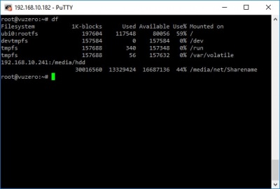

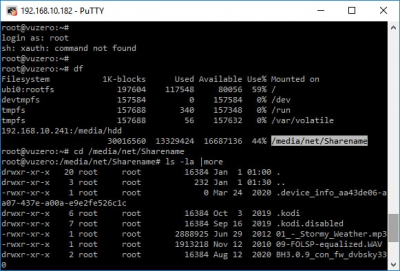

The nfs server in Bh is designed to work between 2 box and it works fine.
We have checked.
root@vuzero:~# df
Filesystem 1K-blocks Used Available Use% Mounted on
ubi0:rootfs 197604 117548 80056 59% /
devtmpfs 157584 0 157584 0% /dev
tmpfs 157688 340 157348 0% /run
tmpfs 157688 56 157632 0% /var/volatile
192.168.10.241:/media/hdd
30016560 13329424 16687136 44% /media/net/Sharename
root@vuzero:~#
We have checked.
root@vuzero:~# df
root@vuzero:~#
