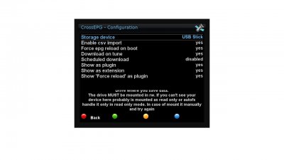

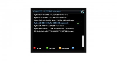

Have you set up cross epg as on the screenshots below?
Is your storage device seen as mounted (hdd or usb)?
