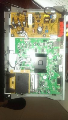

That's what they told me when i bought it...:-) I made a search on the net to find out how to determine if it's a clone or genuine, but apparently nobody can tell for sure. If i believe what they say about some stickers that say v2, v3, etc. that indicate a clone, mine does not have that. I bought it from a retail shop in its original package.

Now, if you can no longer tune sat channels and this occurred after a sudden crash, it's likely that you have a hardware fault.
That's for Vu+ Solo2, mine is Vu+ Solo. I found a similar post on vuplus.com for vu+ solo, but i have to remove the cover to check if it's a clone. I'll probably do it tomorrow and let you know. Thanks for your time Eragon, i appreciate it.
Sent from my HTC One using Tapatalk
Sorry to say that, mate, but as far as I can see, yours appears to more like a clone...:(
Look at the red rear connectors, at the smartcard reader's holes, at the differences in the power board, these things appear different than the original...
