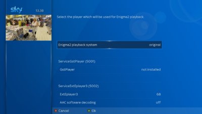

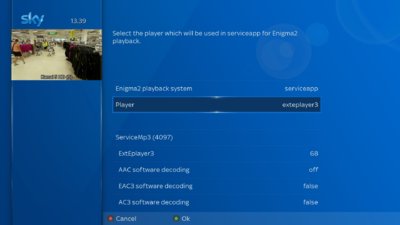

So the solutin is to activate servicApp. You find this plugin in Menu>>Setup>> System>>ServiceApp at the bottom.
Change the default player from Original to serviceApp
Then change player to exteplayer3
Save settings and then reboot.
This should take care of the audio hopfully :)

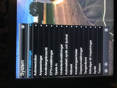

Tror du att det räcker med att uppdatera mjukvaran från Menyn? (Black hole)

The best way to attach a picture is not... a photo. Use the grab command: just type in a browser the box IP address followed by /grab. For instance, if your box IP is 192.168.0.33
192.168.0.33/grab
and then save (right click) the picture you got.
This will also avoid to attach a rotated picture and the picture will be perfect, not just a more or less blurred photo.
