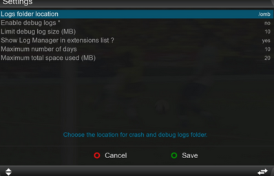

Alex,
Try to replicate the crashlog.
Before do it, try set per example or verify in logs manager, where the craslog´s are defined to.
MENU > SETUP > SYSTEM > LOGS > SETTINGS
There you can enable "debug logs" ... my settings are defined to /omb or as you know to /media/usb/logs
Yes, I had changed the path but did not remember.
