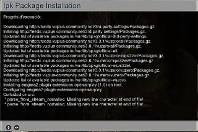

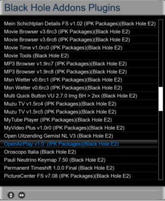

What's up with this plugin in 3.0.1? In 2.1.7 works fine...It doesn't install in last bh version, You can see that in the image:
This plugin has been dowloaded from plugin list inside bh image.

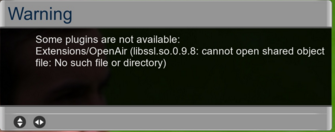

Finally, the version 0.59 works with 3.0.1 but with not posibility to config the plugin, it crash green screen. The 1.0 version works with 2.1.7 and not install with 3.0.1. I know it is not an important plugin for mosy people, but I would be grateful to any commentary. Thank you.
The reason it does not work, is that libssl.so has been updated from version 0.9.8 to version 1.0.0
Maybe if you can find libssl.so 0.9.8 on the internet for mips32el and add it to /usr/lib with 755 attributes it might work, but I don't know (and no I don't have that file sorry).

Pd. Ok I undestand it, I need 1.0 libssl.so version

ok I found the file
Add it to /usr/lib and set it with 755 attributes then restart E2 and try OpenAir again.

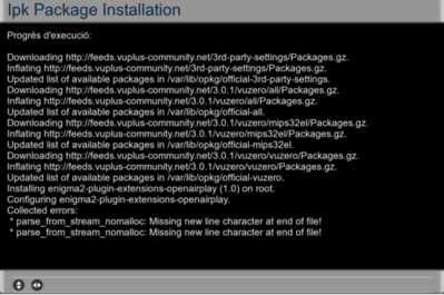

The error comes at the end of non success instalation
upload_2016-1-26_18-24-21.png upload_2016-1-26_18-28-33.png upload_2016-1-26_18-29-7.png

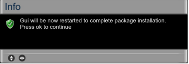

After that, the box reboots and shows the first post image when you enter in plugins panel. The only ipk that works in 3.0.1 is 0.5.6 , by the moment, I hope this will be solved in the future, if it's posible.
