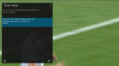

DVB-T usb stick Nova-T (driver dib-0700) working and showing SRN 0% or 1%.
This is problem persist on BH and OBH image.
This one dont work on OBH 4.1 - ct2-dvb-usb-pctv292e - 2.0-r0 - pctv 292e tripleStick
On OpenPli image we have - ct2-dvb-usb-pctv292e - 1.0-r0.2 - pctv 292e tripleStick - this one works, can someone upload the ipk file, or give me some advice.
Ok, i found a way. PCTV 292e usb-dvb-t2/c tuner will be recognized if you install ct2-dvb-usb-pctv292e - 1.0-r0.2 from feeds. OBH feeds have none working t2-dvb-usb-pctv292e - 2.0-r0 driver version. Solution is to change /opgk feeds to OpenPli ones. First backup OBH ones, you wiill restore them later.
First install 1.0-r0.2, after reboot tuner will be recognized and then restore OBH feeds.
If you do OBH online update, 1.0 r0.2 will update to 2.0 r0, now tuner also works with this driver. If you need OpenPli feeds, just PM me.
